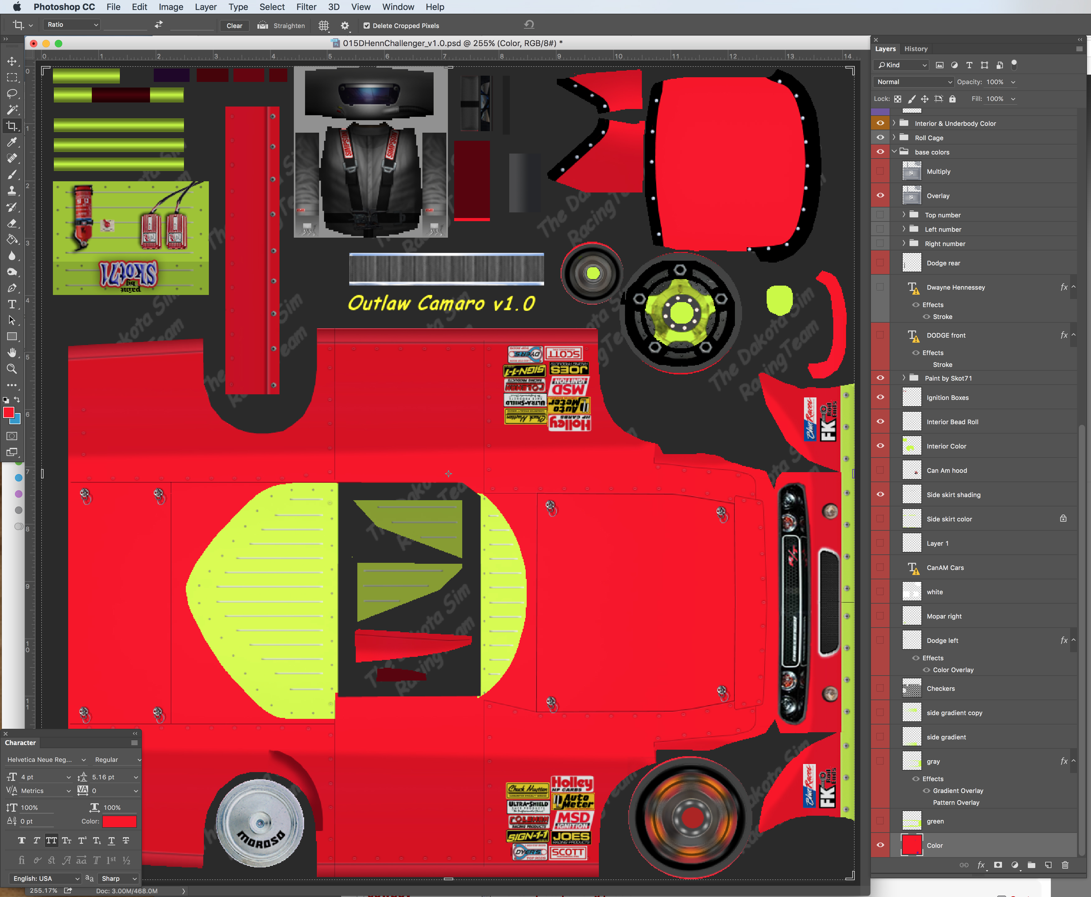

Here's a screen cap of what I am talking about.  I have the latest version of Photoshop, and I'm on a Mac, but your version should be similar, and work just as good.  I had an Outlaw template on my computer here at work, so that's what I opened.  Notice on the layer palette at the right, I have selected the very bottom layer titled Color.  I used my paint bucket tool and clicked on that layer.  What you see in the pic is the result.

That did it when i dragged the layer down it painted as it should. Why i have never had to
do that before, i don't know. Thank you very much.
